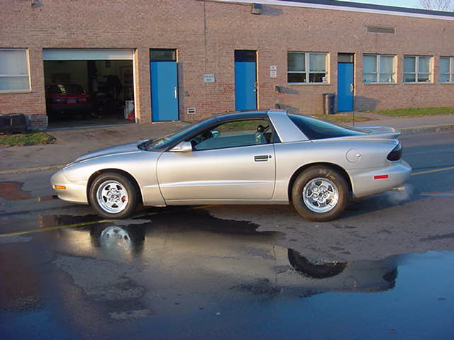

      I put centerline telstars on mine. They fit pretty good with a 5.5 backspace. Another half inch would be better, but theyre not bad for the price.
      No grinding required.
      http://www.centerlinewheels.com/whee...id=13&sw_id=72

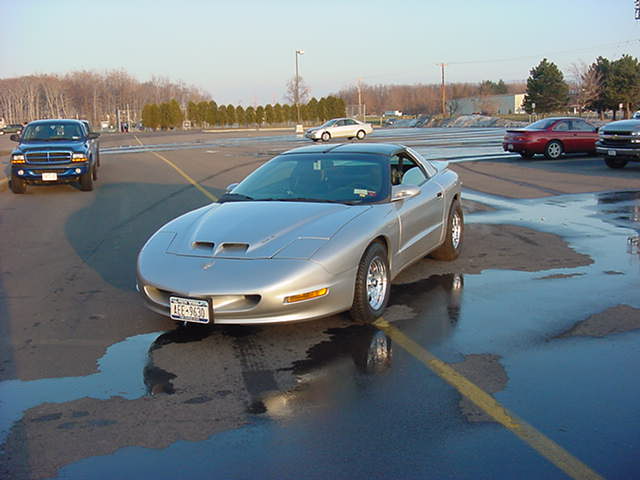

        Heres a pic of them on the car.
          this is little easier to see the backspacing....
            The 15" Telstars are described above... that is the entry level wheel, and does not appear to take any spacer in the front or grinding the calipers in the rear. I think the 15x8 Telstar has a 5" backspace, and that is what moves the tires slightly out from under the fenders. I believe they use stock studs.
