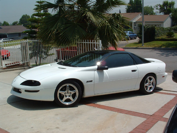

      I have the Eibach Pro-Kit Lowering springs on my car. With this set, and the 17x11 ZR1's, there is some rubbing in the rear, but only when I have passagers in the rear seats, and go over bumps in the freeway. If I were to shave the lip on the inner fender, this would most likely fix the problem. Furthermore, heres a pic to give you an idea of the look.
