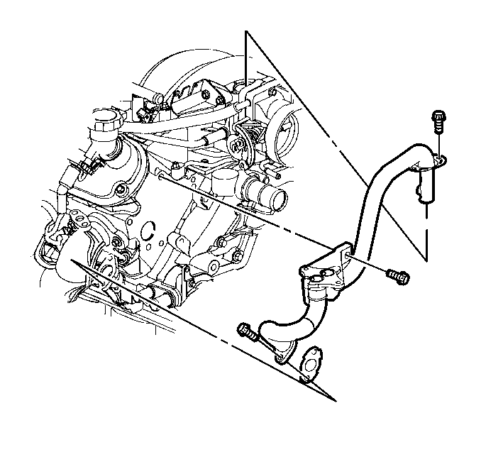

          Yeah....it looks like a single bolt is used. In the pic its hard to tell.
          Remove the EGR valve. Refer to Exhaust Gas Recirculation (EGR) Valve Replacement .
          Remove the EGR pipe to intake manifold bolts.
          Remove the EGR pipe to exhaust manifold bolts.
          Remove the EGR pipe mounting bolts from the right cylinder head.
          Remove the EGR pipe.
          Installation Procedure
          Install the EGR pipe.
          Install the EGR pipe to exhaust manifold bolts.
          Install the EGR pipe to intake manifold bolts.
          Install the EGR valve. Refer to Exhaust Gas Recirculation (EGR) Valve Replacement .
