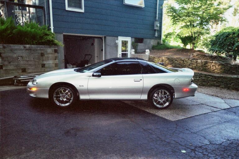

Hey- I just joined, I've got a '98 Camaro SS. Silver, Z06 Vette rims. Flowmaster ext, K+N filter. Real minor bolt ons. I'm looking into the SLP Head/Cam package or a Supercharger next spring. Anyone have any opinions on which would be a better choice. Also in all reality what should my car be running (aprox) in the 1/4. I had a Mustang GT that ran 13.70's and the SS feels waaaaay faster. But I'm not able to get it to the track, so I'm guessing 13.40's or thereabouts. Agreed?

That is a very nice, very clean Camaro SS you have. I would go for the SLP head/cam package if it were me. I don't have an LS1, though, so don't just take my word for it. Although, it seems to me that your car would look a little better if it was lowered. If it was me, that is what I would do first, but it's all up to you.

Very nice SS. Any reason why you want to go with the SLP h/c package. $$$$
