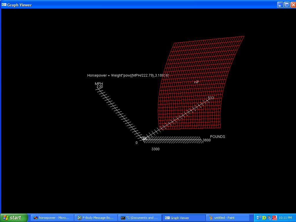

I was slightly dissapointed with my numbers, as I had calculated them using weight and trap speed at about 525 HP to the wheels. The guy that ran the dyno said the the "mustang" dyno gives VERY conservative numbers and if I ran it on another dyno, it would be about 18% higher. So, my numbers arent too bad then.
