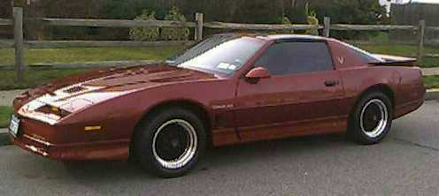

    Hey guys help me out a little i'm an oldie to the F-body world newbie to this forum
    I am in the process of buying a very well...Near perfect 1987 TA
    it's a Stock 155hp 305 carb..72,000 mi (good for now) now he is telling me on start up it blows smoke out the back on startup only.. and the oil pressure is very high recently since he put it away a few months ago it was close to pinned.. im thinking oil pressure sensor switch im not sure
    what do you guys think?
