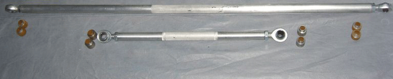

        Our newest completed projects is are Adjustable Aluminum Panhard Rods & Trailing Arms for the F-Body Platform. These feature 1" diameter tubular rods, with wrench flats one one end to help when adjusting, aircraft quality Heim joints (rod ends) and steel bushings.
        Some manufacturers offer these with 3/4" tubes rather than the 1" tubes but our experience has been that the additional stiffness inherent in the larger diameter tubes, help to eliminate any flex in the bar.
        I am working on an addition to our website that will show pictures and offer these parts for sale.
        I am posting a picture of a prototype that uses knurled tubing, however we have found that the wrench flats do a better job when adjusting these.

          1" diameter tubular aluminum just doesn't sound too impressive. Hard to believe anyone would even attempt to use even smaller diameter 3/4" stock. What is the wall thickness, and the spec on the aluminum you are using? Mild steel and chrome moly LCA's and PHR from companies like Spohn ar 1.25". The Coleman Racing "build your own" bars are 1.125" diameter, 0.219" thichness, 6061-T6511.

            That was what I thought when looking into the bars that are out there. There are some larger fixed length bars out there but many of the adjustables are from 7/8" and 3/4" stock, while others offer 1" as well.
            As far as the wall thicknesss for our bars it is .156 on this first product, if people are looking for larger diameter, heavier wall thickness or even solid aluminum, chrome molly tubing or solid, that is something that we can produce as well.
            We can even produce these out of more exotic materials, such as the maraging products or EN30B but you're probably looking at a $700-$800 PHR if made out of one of those products.
