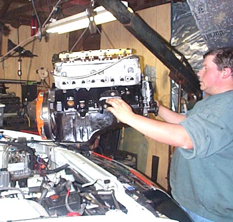

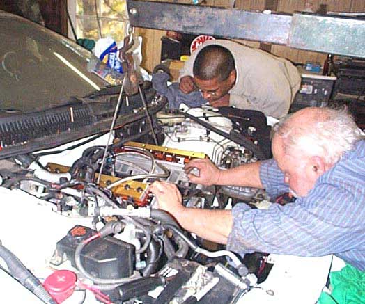

                  Attached are a couple pics of an engine with a fairly tall valve train going into a 4th Gen with the hoist at the nose of the car.
