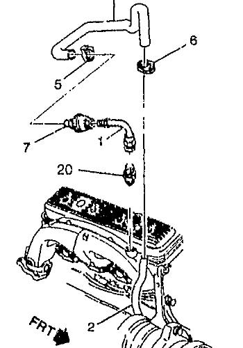

In a momnet I hear ticking and then what sounds like knocking. Oh crap...... I check oil pressure and it's fine, no knock retard on the scanner (It's on anytime I drive) but I shut down anyway, killed the ignition and coasted over to the shoulder. Now I'm getting that sick feeling.
I pop the hood for a visual check. I check the oil... looks great, checked the belt and it's fine. Then I see it..... the rubber hose from the air fitting on the passenger side of the motor had come off the metal tube. I put the hose back on, no noise. Whew!
Dodged the bullet this time. Now I have to wonder what made it come off, that's pretty irregular. All the other rbber connections have a clip, this one didn't. I can't remember leaving it off when I had it all apart. Then again, I can't remember if there was even one on there. Can anyone verify if the J shaped hose on top of the passenger side valve cover that wraps around the oil fill cap and connects to the back of the valve indeed has a clamp or not? The other end that merely connects to the aluminum tube does, I would think that this one should as well.
