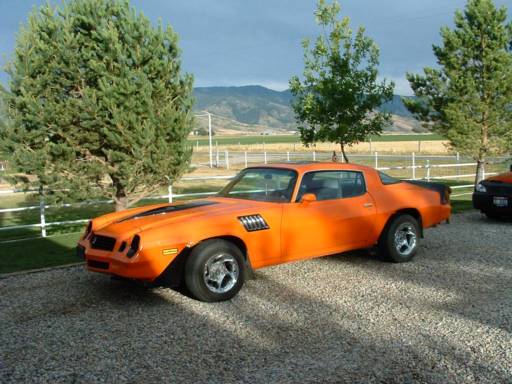

    Here is a pic of the car the exterior is in pretty good shape . the interior needs some work but not alot

            As others said above, depends on what shape the engine is in. But I will say I LOVE the color! Very nice ride!
