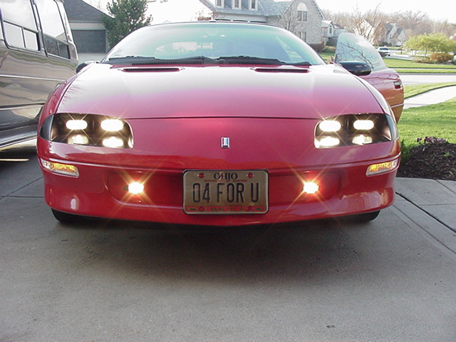

    Hey, I've got a 94 Camaro and I've seen some headlight conversion kits for sale. They look pretty cool in the pictures, but I don't know if it's worth it. Do they work well, how much is involved in installing them, do they look cheap when you put them in, and anything else I might wanna know about them? This is what they look like after you put them in... http://www.bfranker.badz28.com/appea...maro/Piaa1.gif

      I think those conversions look awful. Especially if you look at them close up.

                  Furthermore, I would suggest that you upgrade your lighting with something different, Maro94. Although those PIAA lights will light up the road better, it makes the car look too, "different," to put it lightly. Seeing how our options are limited though, I can understand why you'd go with whats available. But fear not, sooner or later we'll come up with something that looks original and works better!
                    I actually found someone that wants to sell me a "conversion kit" but it's just like the one's you guys have explained to me. It is really handy though, because instead of using silicone to hold it in, he's changed the housing so that the bulbs can be replaced easily. I might go for that. I agree, those other kits aren't really something I wanna go with.
