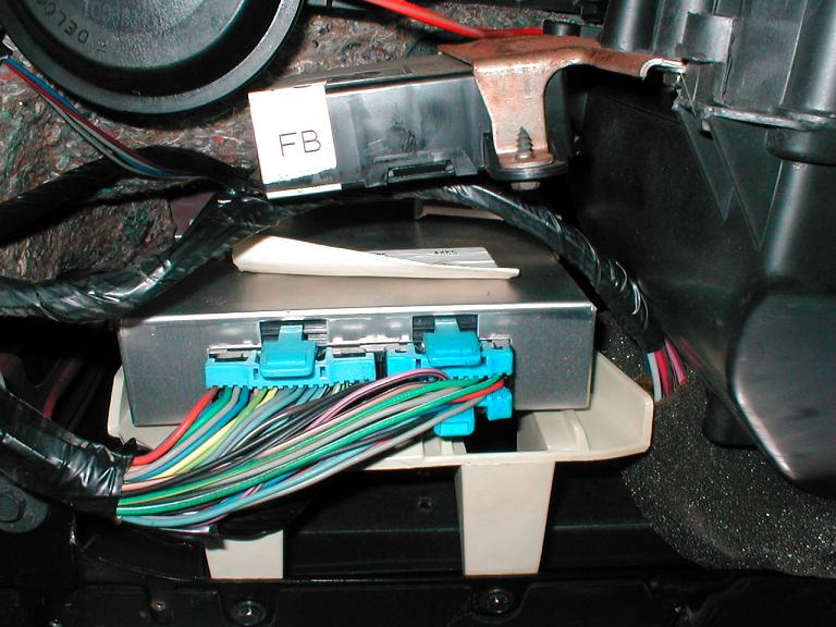

        Oh hey... I can do an attachment. Cool!
        This is the view from the floor pan of the passenger's side of the car looking up into where the ECU sits. See the white plastic "legs"? You are saying there is a clip holding the unit near the top?

          It appears to be just velcroed on, like my 91 Camaro ECM is. Should just be able to pull it forward, and then down. But, honestly, I'm not very familiar with Firebirds.

            I've taken it out on my Firebird, it's the same as your Camaro
              Are we looking at the same picture? There is velcro on the white bracket that holds the ECU?

                Yep, there's a small strip of velcro about 1" long on the white bracket and the bottom of the ECM. Just push the ECM towards the small black box (cruise control module) and it should disconnect and then you can lower the ECM down.

                            I guess the 89 mounts different. Mine has a clip and no velcro you can get at the clip from the bottom if you got small hands ( my cousin she undid it ).
