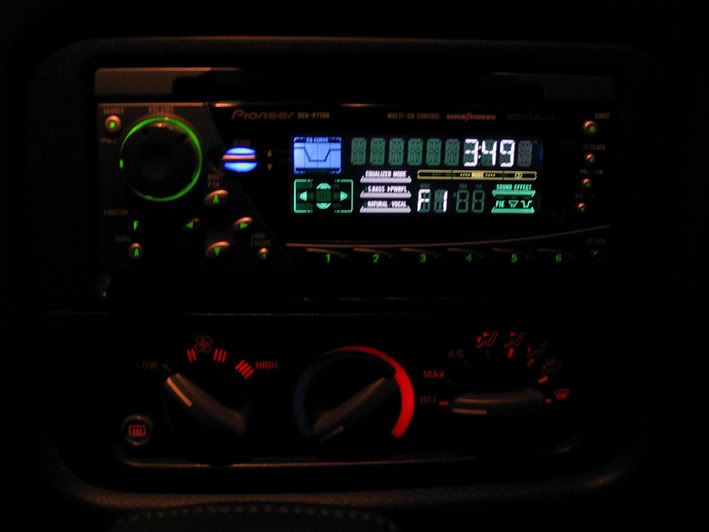

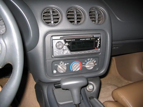

            i really don't like the look of the thinner after market head units with the amount of space our cars have for the radio. So, I bought the pioneer DEH-P77DH.... I looks very clean with no spacers to take up the bigger opening. I'll go take a few pics in a sec. Pioneer is the only two head units I have ever had. (never has skipped in my jeep or my car) I swear by there strength!
            • #21
              Heres some pics...
              • #22
                That's the exact same radio I have too. So if anybody is wondering what my dash looks like, look at that pic and change the auto to a manual and there you have it
