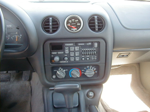

The 2-5/8" gauges fit just right in the A/C vents.
I have nitrous pressure, fuel pressure and oil pressure in the vents, and tranny temp and oil temp on the A-pillar.Fred
When you pull the vent "eyeball" out, the resulting opening is exactly the correct size to FIRMLY hold the gauges in place. You make all your connections, then push them into the hole.
In fact, it can be sort of hard getting the 1st gauge back out of the hole. Both my nitrous pressure gauge and the oil pressure gauge have an -AN hose that is routed through a hole I drilled in the ducting. The wires for the lights and the electric fuel pressure gauge pass through the same hole.
They will stay there, mounted solidly.Fred
