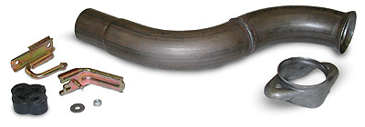

            The loudmouth installation kit has an S-pipe that looks like the following attachment...but am still wondering why it's needed before the cat

              So I guess it is after the cat.
