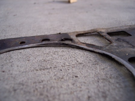

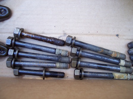

I'll give some major key clues and we'll see who can guess what it was.
94 LT1, 6spd, SLP CAI-Shorties-2 on the left, Random cat, centerforce DF, SLP lightweight flywheel. 168,000 miles
4 second cranking to start when warm
Stumble below 2k in closed and open loop (bad stumble when in 6th)
New Opti, plugs, wires, fuel pump, fuel filter, egr, pcv
158 Long term fuel trim on passenger side.
Swapping sides with the injectors didn't move the 158 to the other bank.
Cleaned extremely dirty and oil saturated Throttle Body w/ new gaskets
Fuel pressure in spec and steady w/ clean injectors
You can assume all replaced parts were good.
I got more good clues, or I'll just tell you if I'm being a dork about it.
Sean (happy to know why!!!)
We'll just in case somebody ever searches for this problem, here is the answer.
