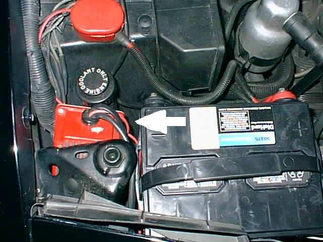

                      Any of you guys have pictures of your box set ups???
                      96 Camaro Z28, T-tops, 6 Speed, Slp CIA, Flowmaster cat-back, 3:42 gears
                      • #26
                        Mine is tucked right between the hood stop and the neck of the coolant bottle........
                        • #27
                          that looks like a pretty good place to put it, any others?
