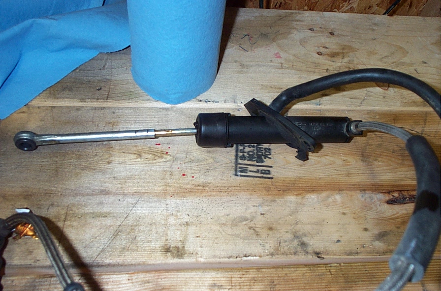

This is the assembly. It comes as 1 piece. The manual says you can not replace a piece of it. It says it is only replaced as an assembly. The connectors are formed on. You can't use a regular clamp on them. They will blow off under the high pressure.
This is the master.
This is the slave cylinder.
This is the reservoir.
Its under the Brake booster. You have to disconnect a clip on the clutch pedal under the dash, remove two nuts under the dash on the firewall and push a u-bolt out. Also dettach the fluid resovoir. Then from under the car wiggle and jiggle the master out of the firewall and remove the master and the slave as a whole, no need to pop the fluid lines loose. The hard part is by far getting the master back in the firewall and popping in the u-bolt. Get a helper to get the u-bolt in.Originally posted by 96CamaroWhere in the world is the master at then.....My stupid repair manuel says its just the thing that holds the fluid (probly need a new repair manuel).1995 Z28 Convertible, 350ci LT1 73K miles M6.
