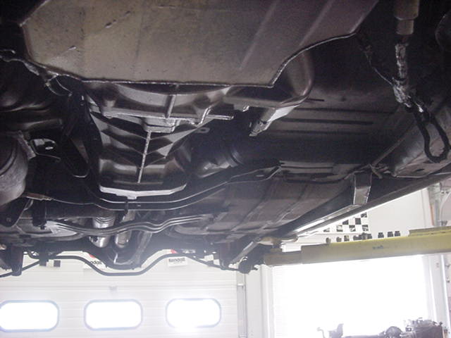

sub frame connectors
I use slp sub-frame connectors and i dont have a single complaint about them I think they are great. and they are not that expensive.
http://slponline.com/view_product.asp?PARTNUMBER=70801
