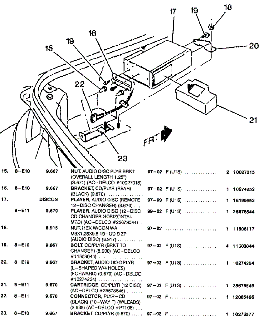

Does anyone know what the part number is for the Factory 12 disc changer for a 2002 Firebird? Also, is there a mounting bracket for this, or is does the unit have a built in mount? Thanks for your replies.

i dont have the part number.....but there is a mounting bracket. i installed one in my compTA. the cars are prewired for them. install it on the little shelf on the left side of the hatch well. pull off the vinal pannel there, the wire has tape (97's did) over the connetor..... just plug it in and your set to go. 10 min. install. i drilled two holes on the shelf and used big sheet metal screws. never a prob. that was 4 years ago.

http://www.gmpartsdirect.com/ did not have a listing for the cd changer. Hope the picture helps.2002 Electron Blue Vette, 1SC, FE3/Z51, G92 3.15 gears, 308.9 RWHP 321.7 RWTQ (before any mods), SLP headers, Z06 exhaust, MSD Ignition Wires, AC Delco Iridium Spark Plugs, 160 t-stat, lots of ECM tuning
chickenwing
That picture was awsome! Where did you get that at? I want to get a copy of whatever you are using.
I cut and pasted the picture together from a pdf file I downloaded from http://www.abrinoperformanceengineer...T1%20%20stuff/ . I hope you have a high speed ISP.2002 Electron Blue Vette, 1SC, FE3/Z51, G92 3.15 gears, 308.9 RWHP 321.7 RWTQ (before any mods), SLP headers, Z06 exhaust, MSD Ignition Wires, AC Delco Iridium Spark Plugs, 160 t-stat, lots of ECM tuning
