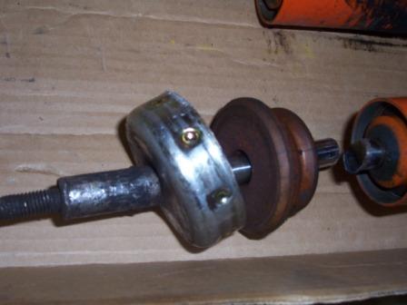

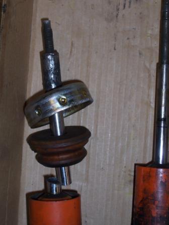

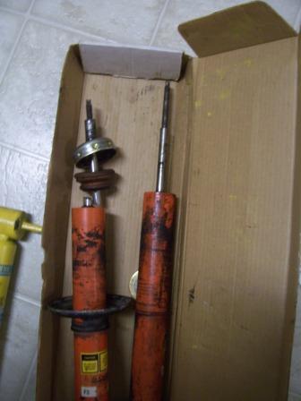

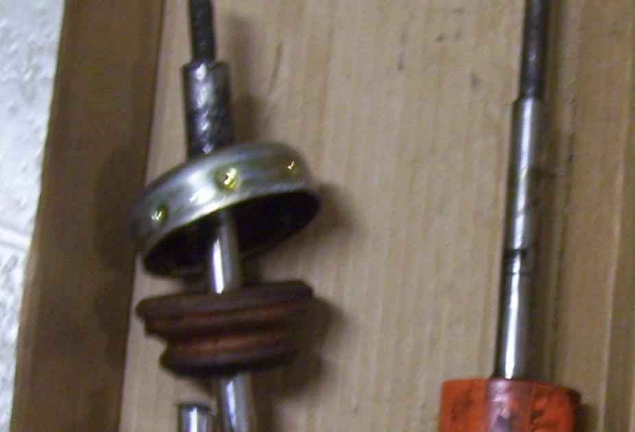

Here's all the parts in a stock shock setup, from my unmolested/bought it new 1994:
Which parts are you referring to? The black sleeve is both a dust cover, and the jounce bumper. The top of the sleeve has a crumbly white rubber jounce bumper in it.Fred
Looks like it might be a metal cap or whatever is under the plastic shroud on the stock dust cover.... like the plastic was broken away and lost, leaving just the metal cap and the rubber bumper. Doean't explain why its only in one side. Its 8 years since I changed my stock shocks, but I thought the rubber bumper in the stock cover was a white material, and not black.
In any case, its not what needs to be there. I like the dust cover, and you need a jounce bumper, because there is no provision elswhere on the front suspension to limit compression. Many people just leave it all off though.Fred
