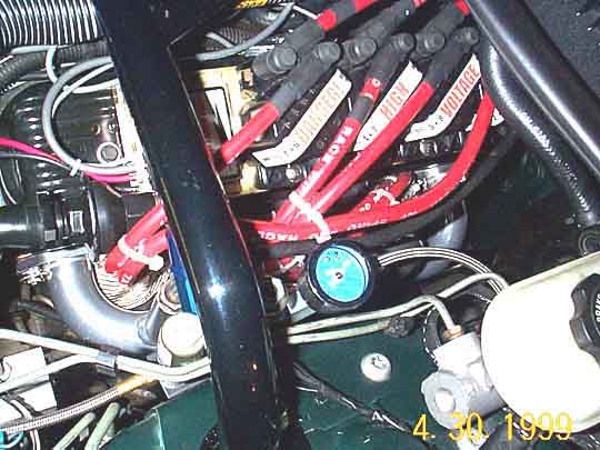

I wouldn't bother using the metal heat shields. Most premium wires have high temperature boots that will stand up to header heat. The fact you have your headers cera-metallic coated reduces that heat level a bit. I don't know what the Granatelli wires look like... they aren't very popular. I run a set of MSD 8.5mm SuperConductor wires, and do not use the metal boots. Wires have been intact for 8 years now. My wire routing is completely under the headers, not over the top.
If you have a close fit, consider using the Taylor woven fiberglass "Fire Sleeves". I used them when I squeezed 10.4mm Taylor 409's under a set of shorty headers on my LT1.Fred
A friend of mine tried that once when he ran the wires over the top on his old LT1. It didn't work out so well though, because he burnt the wires off 3 cylinders and was misfiring hard on the other 5 - those 'fire sleeves' didn't do anything for him. It was probably just the fact that he ran 'em over the top and tried to wire-tie them in place that caused the issue.Originally posted by InjuneerHe has "KOOKS HDRS W 1700 degree coating".
Exactly the way I ran the 409's, and the fire sleeves worked perfectly.Originally posted by 99Firebird3800A friend of mine tried that once when he ran the wires over the top on his old LT1. It didn't work out so well though, because he burnt the wires off 3 cylinders and was misfiring hard on the other 5 - those 'fire sleeves' didn't do anything for him. It was probably just the fact that he ran 'em over the top and tried to wire-tie them in place that caused the issue.Fred
I did that with mine for about two years, just recently switched back to the under plug and port set up again.Originally posted by 99Firebird3800A friend of mine tried that once when he ran the wires over the top on his old LT1. It didn't work out so well though, because he burnt the wires off 3 cylinders and was misfiring hard on the other 5 - those 'fire sleeves' didn't do anything for him. It was probably just the fact that he ran 'em over the top and tried to wire-tie them in place that caused the issue.
Over the top and through the headers, never had a single problem without any protection whatsoever. The guy before me did, but he was a tool.
