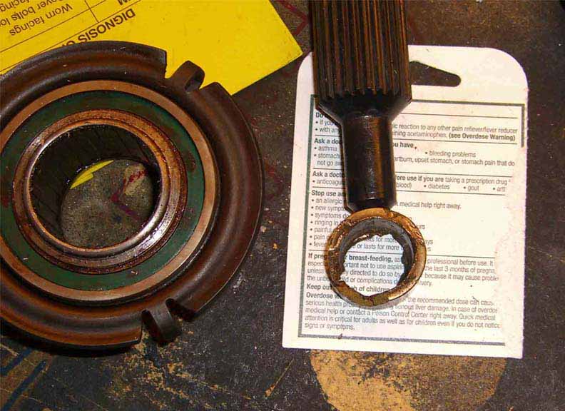

                I'm garaging the thing from this point on until I figure it out, this noise has got to mean big trouble, I'll post a picture of whats left of the old pilot bearing so you can get an idea of how much input shaft play there really was.

                  .This is the image of the old brass pilot bushing next to the alignment arbor and TOB. There is a 4 mm section missing that had to be chiseled away in order to crush it away from the crank insert, so its actually a little more worn than it may appear in the image.
