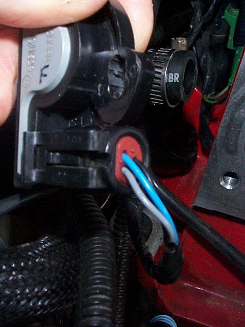

Here is my delimma. I have a 95 Z28. I was searching for a new TPS connector/pigtail and all I could come up with is the 3 pin FLAT style connector. My car has the 3 pin ROUND style connector. After some searching I found that the 93 cars have that same type of round connector as what I have in my 95. Should I just purchase the round/93 connector and call it a day? Through my ownership of the car I have never noticed anything wrong as long as the car is running right.
93 Throttle Position Sensor Interchangeable With 95?
Shoebox's pigtail list shows the same part # for 93-97.
PT375 1993-1997 TPS and a/c pressure sensor 12102748
My 94 has a round connector. When I had a problem with the wire sequence, Shoebox sent me a photo of his 95, and it was a round connector.
Shoebox's 95 from his website:
http://shbox.com/1/tps.jpg
My 94:Fred
