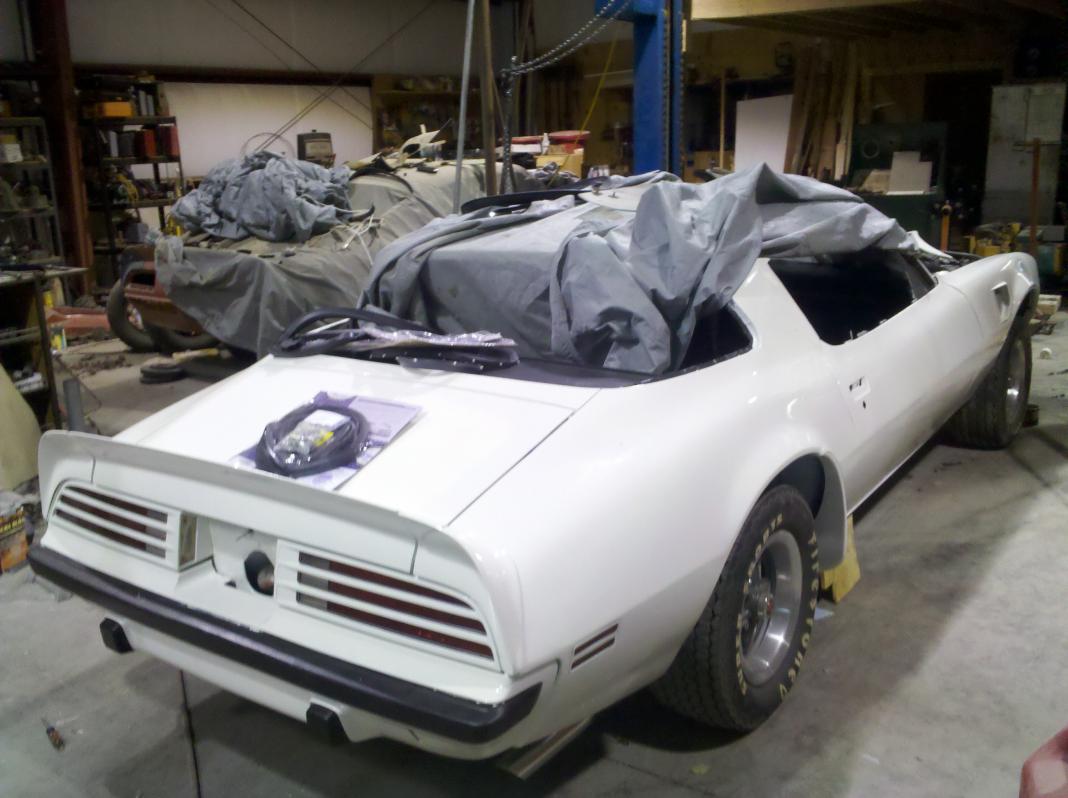

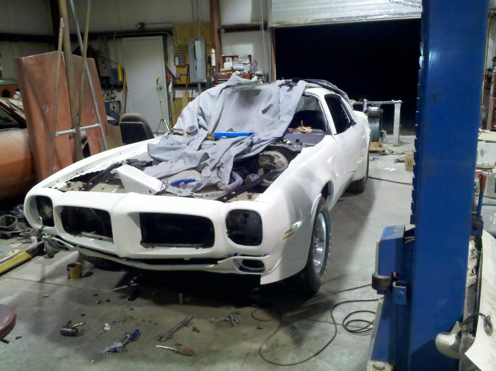

 Thanks for the encouragement. After looking at a number of valance pictures on the web, I figured the large depression in the middle of the valance shouldn't be there. It looked like it was intentional but it was someone's addition. I pounded it out and repainted it this morning. The valance is still not fitting perfectly but it's a little closer. I'm going to try and shim the lower part of the fender and see if that doesn't improve the fit a little. Tomorrow the paint should be cured enough to try installing the valance. Here are a couple pictures I took with my cell phone if you're interested....sorry about the quality. Don't suppose anyone would have the little bracket that the valance attaches to in the front right under the bumper? I made one today and it works but it may not locate the valance correctly. I've been working on this for a few years now and I'm within striking distance of getting it done. I've took a few vacation days to see if I can't get the body and interior assembled.
