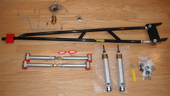

Got some new suspension goodies, one of them being a Random Technology Adjustable Torque Arm. Just a little bit confused on measuring the pinion angle. I bought a mechanical protractor from Home Depot, but not sure where to place it to get correct readings. Anyone done this before?
