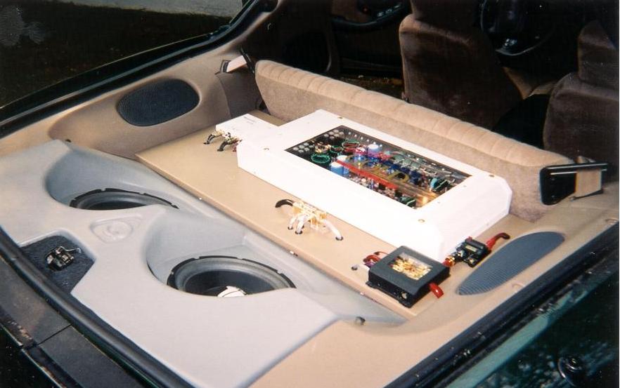

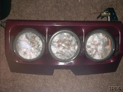

                        I like those ideas! I am probably going to run the nitrous lines inside the car, then split loom under the hood. Yeah, the hardest part is going to be concealing the nozzle though. Originally I was going to mount it in the storage area, and add the JL audio 3-10" stealthbox over it. The box is completely made in fiberglass, with a gel coat over it that can be painted to match the exterior. The best part of the box is that it uses a linear actuator to raise the box to get into the sub storage area. No one would ever be the wiser!

                          Good luck finding that box. JL doesn't make it anymore, and finding somebody who is willing to get rid of it means ebay, and they go HIGH dollar. I wanted the same thing, but I got off my lazy butt and used my 15 years of car audio experience and built my own box. It's not "showy" like the JL, but it gets the job done.

                              MN6WS6 - I have that box. Took me about a year and a half to acquire though! Ebay Except it needs the runners and linear actuator. Some kid tried to fit bigger speakers into it and really hacked up the fiberglass bad. It is a work in progress restoring it. 15 years in Car Audio... been there too, but probably like 10. You would probably appreciate this setup. Sony CDX-C90 head unit up front, JL 6.5 subs custom fitted into the rear panels, MB Quart seperates up front, 2 Old PG Sapphire 35x2's in the back. The stuff I have out of the car to go back in - (3) 10" JL W6's, the competition stealth box, and an ancient PG amp, THE MS2250! Here is an old pic of the setup.
