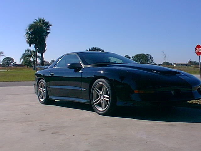

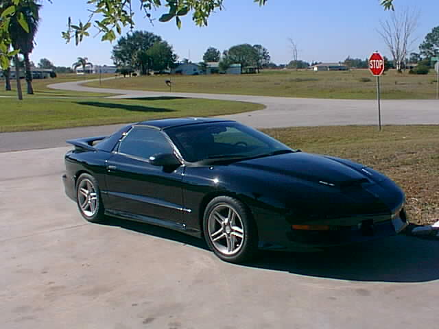

    I have to say I am more than pleased. The fender lip is exactly 26.5" front and back, the car sits just right. Handles like on rails too. The pic isn't the greatest, I'll get a better one when it warms up.

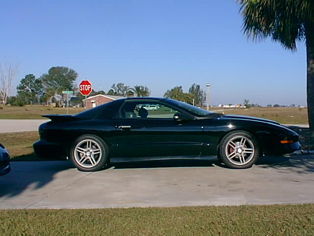

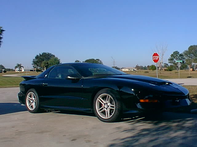

              Here are a couple more pics with a better lighting angle:

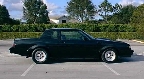

                          Btw Joe, just what have you done to the GN? I don't think I've ever asked you that? lol
                          Steve
                          87 GN - its just a 6... Mods
