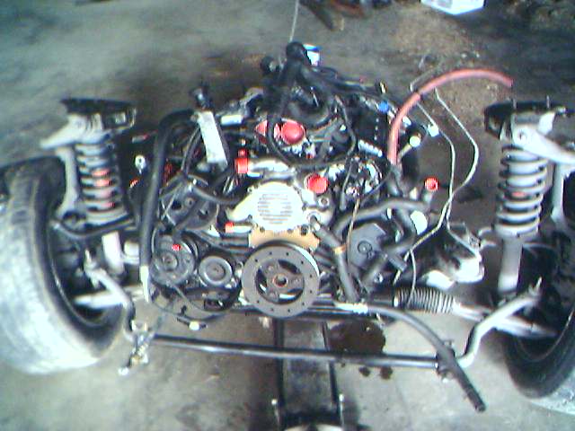

When you did yours from the bottom, did you have to remove the swaybar? Some guys over on other boards have claimed they were able to get the motor to clear it, but it seemed a bit of a stretch to me. Let me know.Originally posted by 94 formulaIf I made it sound like anyone was wrong for taking it out the top I'm sorry that was not my intent and in no way am I saying that one way is better than the other.
fastTA, that guy in the link did more than was necessary to drop the motor from the bottom and when I did it I used a lift which seemed to make it much easier I was able to just lift the car up and pick up the back of the tranny and wheel it out from underneath.

I removed the two bolts on each side that held the swaybar to the frame but left it connected to the suspension. You either have to remove it from the suspension or the frame if not it wouldn't let the engine drop. Heres a pic its not the best quality but you can see on the sway bar where it bolts to the frame and has to be removed there or from the suspension I really don't know how it would be possible to not remove one or the other.Originally posted by fastTAWhen you did yours from the bottom, did you have to remove the swaybar? Some guys over on other boards have claimed they were able to get the motor to clear it, but it seemed a bit of a stretch to me. Let me know.1994 Firebird Formula, M6, Fan switch, 160 thermostat, Pacesetter LT headers, Morosso CAI, TB bypass, True duals.

That's what I was thinking. Any more pics of when it was coming out?Originally posted by 94 formulaI removed the two bolts on each side that held the swaybar to the frame but left it connected to the suspension. You either have to remove it from the suspension or the frame if not it wouldn't let the engine drop. Heres a pic its not the best quality but you can see on the sway bar where it bolts to the frame and has to be removed there or from the suspension I really don't know how it would be possible to not remove one or the other.
One thing I would add is that I basically have my entire front end taken apart so the radiator was removed. That gave me all the clearnace we needed in the front. The radiator was not hard to take out but I would imagine that you would not necessarily want to remove it if you did not have to.
