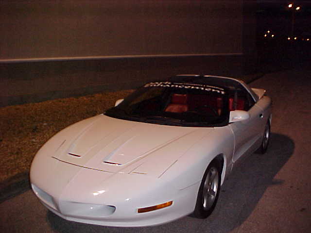

I purchased a 95 Pontiac Formula about a year ago at a used car lot “I was searching for an LT-1 Formula that was black with T-Tops, and a T-56... with no luck;” I settled for an Artic White LT-1 bird, with T-Tops and a 6 speed; with plans of painting it black. The interior stood out the most… Torch Red leather. This is my 3rd Forth Gen. Formula I have owned; so I am very familiar with the cars.

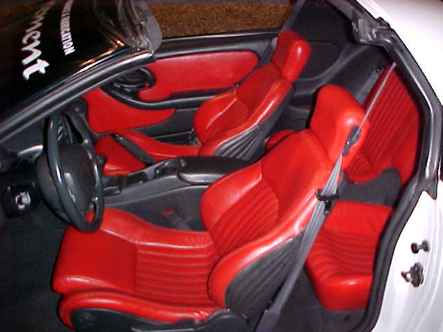

I figured a pervious owner had the seats recovered…? No, turns out they are factory covered seats and door panel inserts. The option codes “in the glove box” show two interior codes; 70I “Interior Trim - Torch Red,” and 702 “Trim Combination Leather - Torch Red.” Now, to my knowledge, Torch Red interior was only offered in the Camaro’s and Corvettes, not the Pontiac F-Bodies?
